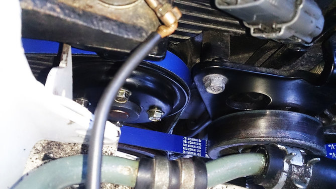

BTW new parts has been arrived:
Kevlar Gates Racing belts.
